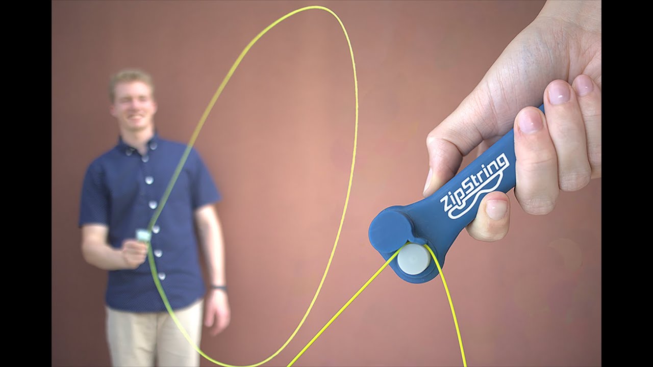

A similar device but working with a box including two motorized wheels turning in the opposite direction, with the string between the wheels:
ZipString - Can you push a string?
You may have heard the saying: “You can’t push a string” It generally means that something is impossible, insurmountable, or hopeless. Because, who could push a string, RIGHT? Well, now when someone tells you, “You can’t push a string.” Pull out your ZipString, and do the impossible anyway.
