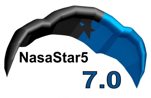

The Nasa ParaWing was invented by Francis Rogallo in 1961 as part of research as a means of space capsule recovery. Since then it has been modified into several variations of steerable kites. They are a fixed bridle kite that are flown using 2 lines or 4 lines. The exception being the Nasa Star which is flown as a 2 line kite but utilizes a 3rd line that will partially or totally collapse the nose to reduce or kill power when used with an adapted 3 line bar.
