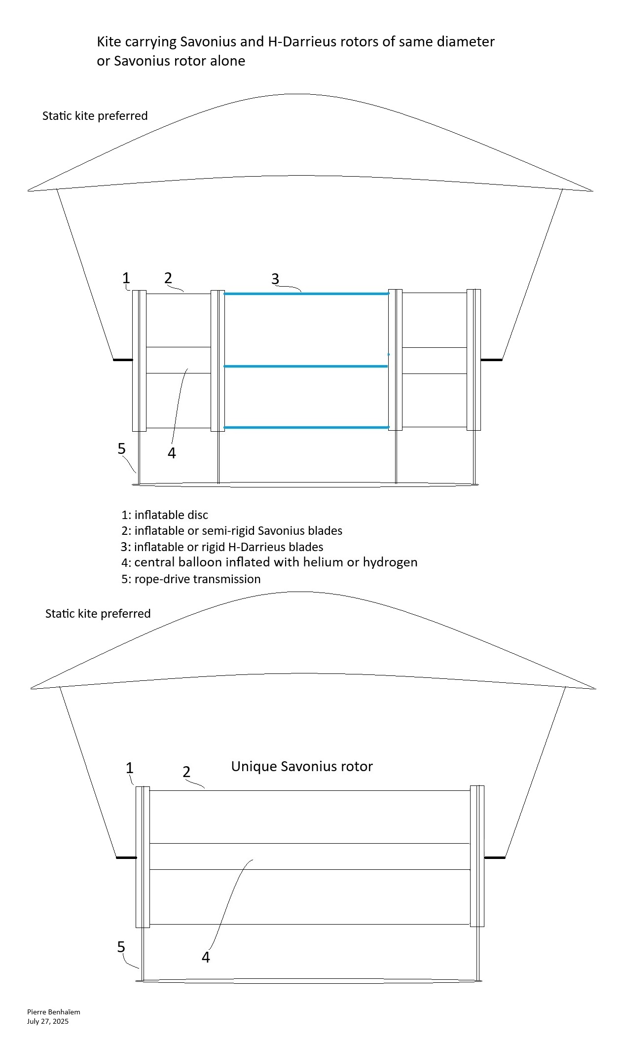

Savonius and H-Darrieus rotors of same diameter and same TSR
The Figure 6 [6] represents curves indicating that a high or correct power coefficient (Cp) at a low TSR (below 1) with cambered blade at a relatively high solidity. As a result, the Savonius and H-Darrieus rotors can be of same diameter, as shown on the sketch below. Two advantages are an easier maneuver, and a lesser deformation problem [4] when inflatable [2 and 3] H-Darrieus blades are used.
Unique Savonius rotor
A unique Savonius rotor could also be implemented to simplify.
Sketch
The two types of rotors described above are represented in the sketch below.
Design of the Savonius rotor(s)
The publication titled “Magenn Power Inc. - Magenn Air Rotor System (MARS)” [5] indicates a new design of “MARS” (Savonius) rotor in the pages 25, 26 and 27. The sketch above picks up certain elements but not “The moveable “clamshell” style blades were operated with compression cylinders, allowing them to pivot open and then retract during each rotation cycle” (page 25 [5]). Indeed, this would lead to an excess of complexity and a possible loss of Magnus effect. The selected elements are the large and well-shaped blades around the balloon. They are fixed on the inflatable discs which include the rope-drive transmission leading to a greater lightness because the generator is at ground.

About the “Unique Savonius rotor” represented on the sketch on the previous comment:
A unique Savonius rotor could also be implemented to simplify. To enable greater scalability
and improved attachment of the S-shaped blades, the central balloon could be a
SHAPEWAVE® beam [3], where the “pressure class” is “0.5-1.0 bar”, or a Tensairity® beam
[7], leading to both lightness and stiffness. An envelope including a light rigid frame could
also be a possibility.
I am concerned that the cable drive used in these schemes will not satisfactorily work. The tension in the cable drive must be high. In the case of the above, the device generates the tension, whereas, in the case of the Kitewinder system, the tension is supplied by a lifter kite which is separate.
Two motorized winches rotate the balloon on:
See also the design where (reverse action) the rotation of the balloon acts the generator (like that I propose) on Magenn - Engineering / Crosswind Kites / Planes - AWESystems Forum.
The balloon-based device would generate tension by drag and by lift (Magnus effect) forces, plus aerostatic force.
Indeed the non-separation of device for tension and device for rope-drive transmission can perhaps be an issue. Experiments would be required to see if the transmission works well and is smooth enough.
I remember an old experience with the Sharp rotor. I placed a sort of rope-drive around (although the Sharp rotor is not quite circular in shape), intended to drive a pulley in free spin under the effect of the wind. No rotation.
But when I manually operated said pulley, the Sharp rotor turned easily. At that moment, I thought that the low torque of the Sharp rotor was insufficient to generate rotation by driving a pulley, even in free spin.
However, I just repeated the experiment with a kite airplane with rotating wings utilizing Magnus effect, whose wing profile is quite close to that of a Savonius rotor. The same result: no rotation with the fan when I put a loop around a rim surrounding a wing, while I could easily rotate the Sharp rotor manually by acting the same pulley through the same rope-drive.
I believe that the tension, which is nonetheless necessary, prevents rotation. As you suggest, the tension should mainly be provided by another separate element, like Kiwee’s kite lifter.
Perhaps a version with a lifter kite could allow a workable rope-drive system?
WO2017153686A1 - Eolienne aeroportee - Google Patents (Kitewinder, Kiwee) indicates a problem when the pulley guiding plan (here around the Savonius or Darrieus rotor) is perpendicular to the axis of rotation. Here this problem is not solved with the addition of the lifter kite. The same for the device sketched on Flettner balloon and VAWT side by side - Engineering / System Design - AWESystems Forum.
