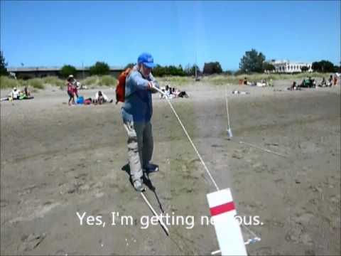

Sharp Cyclo-Kite (11)
2’ span; 5" chord; 0.16 kg; 4mm Coroplast; TSR = 2; hold poles steady, TSR jumps to over 3; tight circles, high centrifugal force, high power; estimated orbit diameter = 6 feet.
