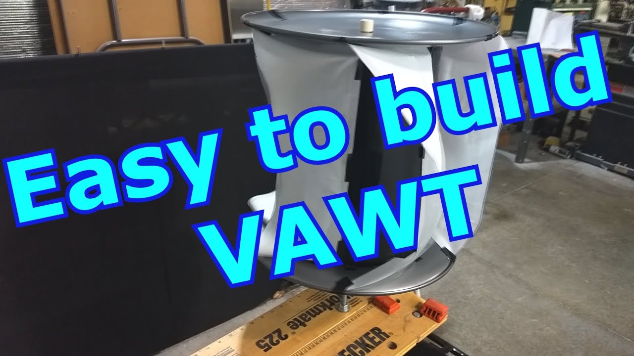

A new type of VAWT that is easy to build
From about 20:30-21:00:
The blades collapse as they move against the wind, offering less resistance to the air.

I agree that folding the upwind-traveling blades of a Savonius (drag) type vertical-axis turbine would be a logical approach. Even I, with my vast knowledge and experience with wind energy, am not immune to wanting to tinker with such inadvisable design directions as drag-based vertical-axis turbines. I can just picture a big one in my backyard right next (below) to the 10 kW unit on the 120-foot tower.

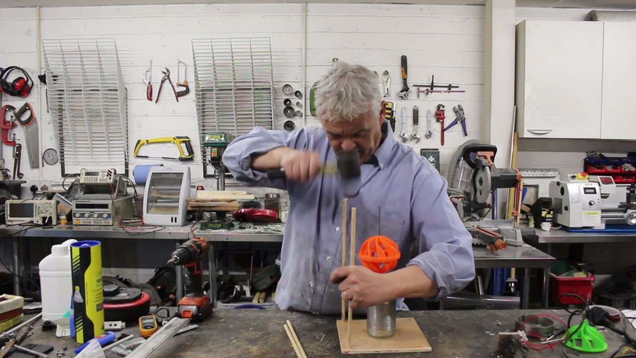

Meanwhile, this guy has re-created the Magenn rotor, with its floppy fold-back blades. A few “symptoms” of “the syndrome” (like red spots for chicken-pox) are:

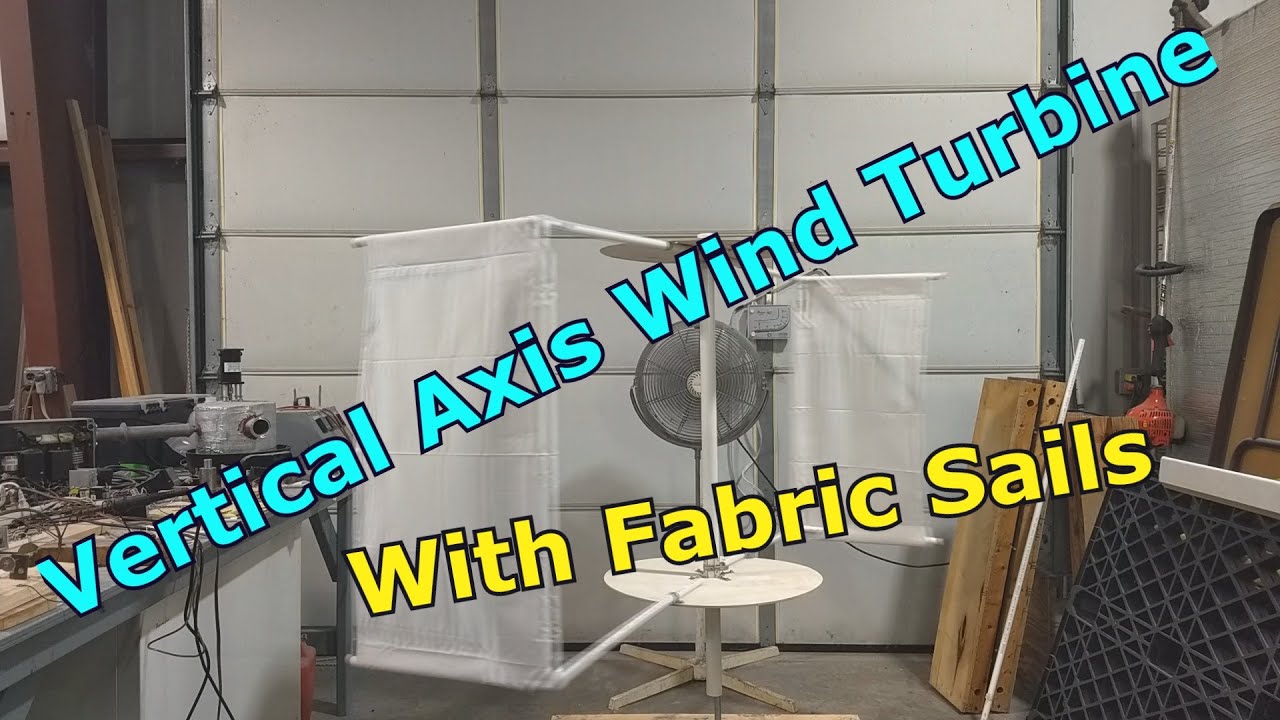

  1. using a household fan as a “wind tunnel”.
  2. Pursuing vertical-axis drag-based machine indoors in front of that household fan
  3. not connecting a generator
    These people represent the “look, it spins!” crowd.
    Funny, he starts out worrying about how to pronounce “turbine”, as though that really matters. At least he admits Savonius is scam territory - there are many stupid investors.
    “A very flimsy support can be used!”
    (yes when you are fooling around making zero power, you can often use minimal support)

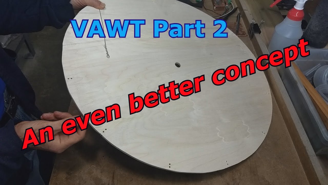

OK I found Jim’s next vertical-axis turbine.
He’s replaced the trash can with arms of PVC pipe.
Did you know another symptom of “The Professor Crackpot Syndrome”?
Using PVC pipe.
Indoors.
Using a fan.
See, the good professor is stuck on “amateur hour”.
He basically has zero machining or fabrication skills, so on the periodic table of the elements, he recognizes the best element for strength and ease of fabrication has the chemical symbol PVC.
That way, he can build to his heart’s content, without the need to develop any skills.
Best of all, his results will be weak and floppy, so he can just pretend it doesn’t work that well because it is just a “prototype” using PVC pipe, and then, instead of showing any results, he can send you off to watch his next video.
