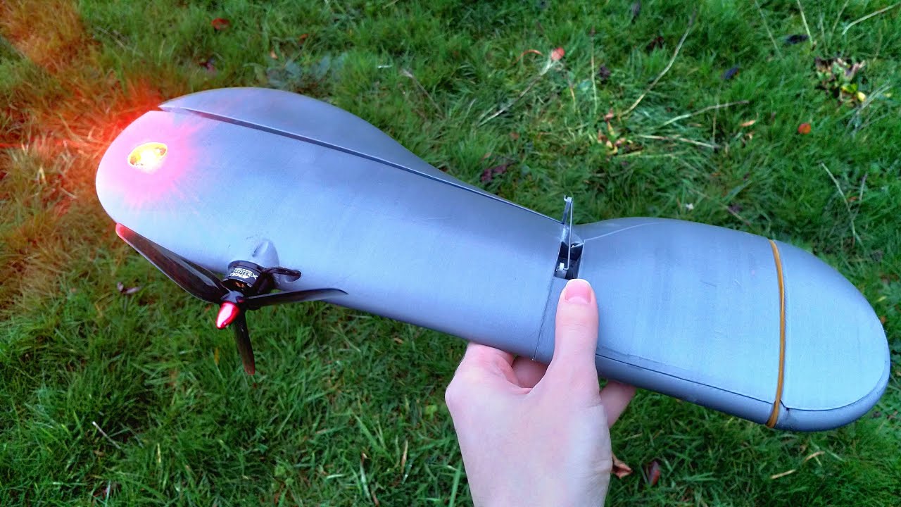

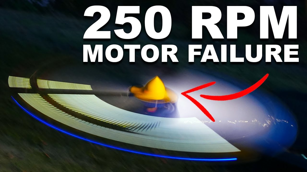

Nick Rehm has updated the Spinning drone with rotary position awareness.
This has brought a level of rotor control which I’m sure @someAWE_cb will be interested in.
Has full control of steering with only 1 / 3 motors working
In addition to the previous comment:
Text on the attached video, at 0:08:
Red is powered, blue and yellow props are windmilling

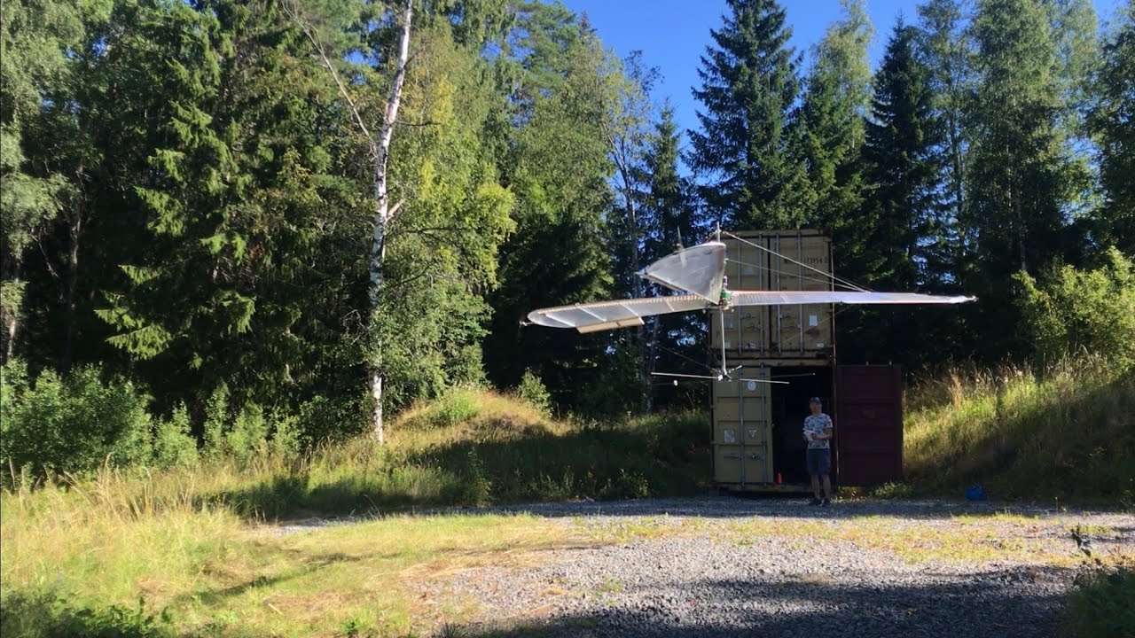

More progress on large scale tip rotor “levitator” testing

My condolences for your father. Indeed he taught you about sails and what catches the wind, as we have seen for a long time.
Much remains to be explored, as this interesting video shows.
