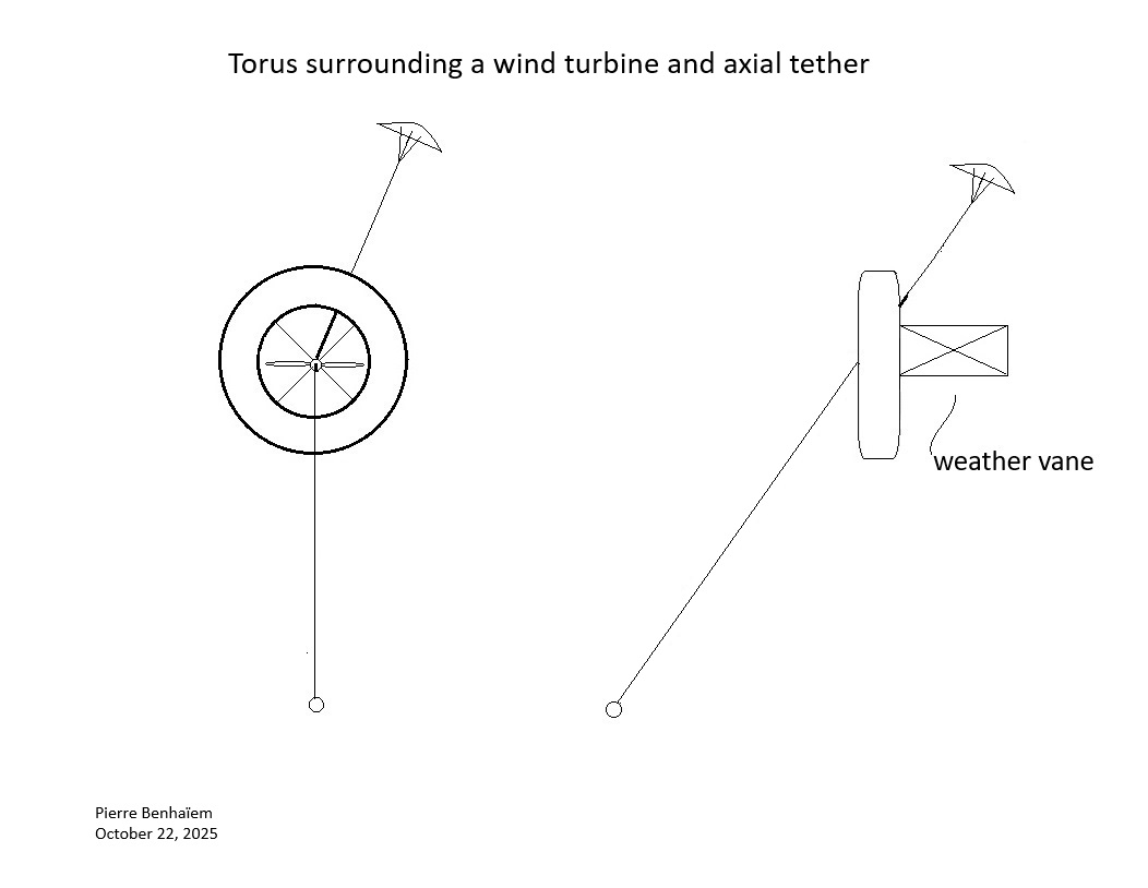

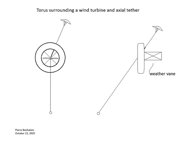

A torus surrounding one or more wind turbines was discussed here.
With the wind turbine described above, assuming a rotor diameter of about 2.5 m, a torus with an outer diameter of 4.725 m and an inner diameter of 2.7 m, aerostatic lift of about 10 kg, could be carried by a lifter kite even with light winds.
Thus, we have a regular wind turbine, an aerostat (torus), and a lifter kite.

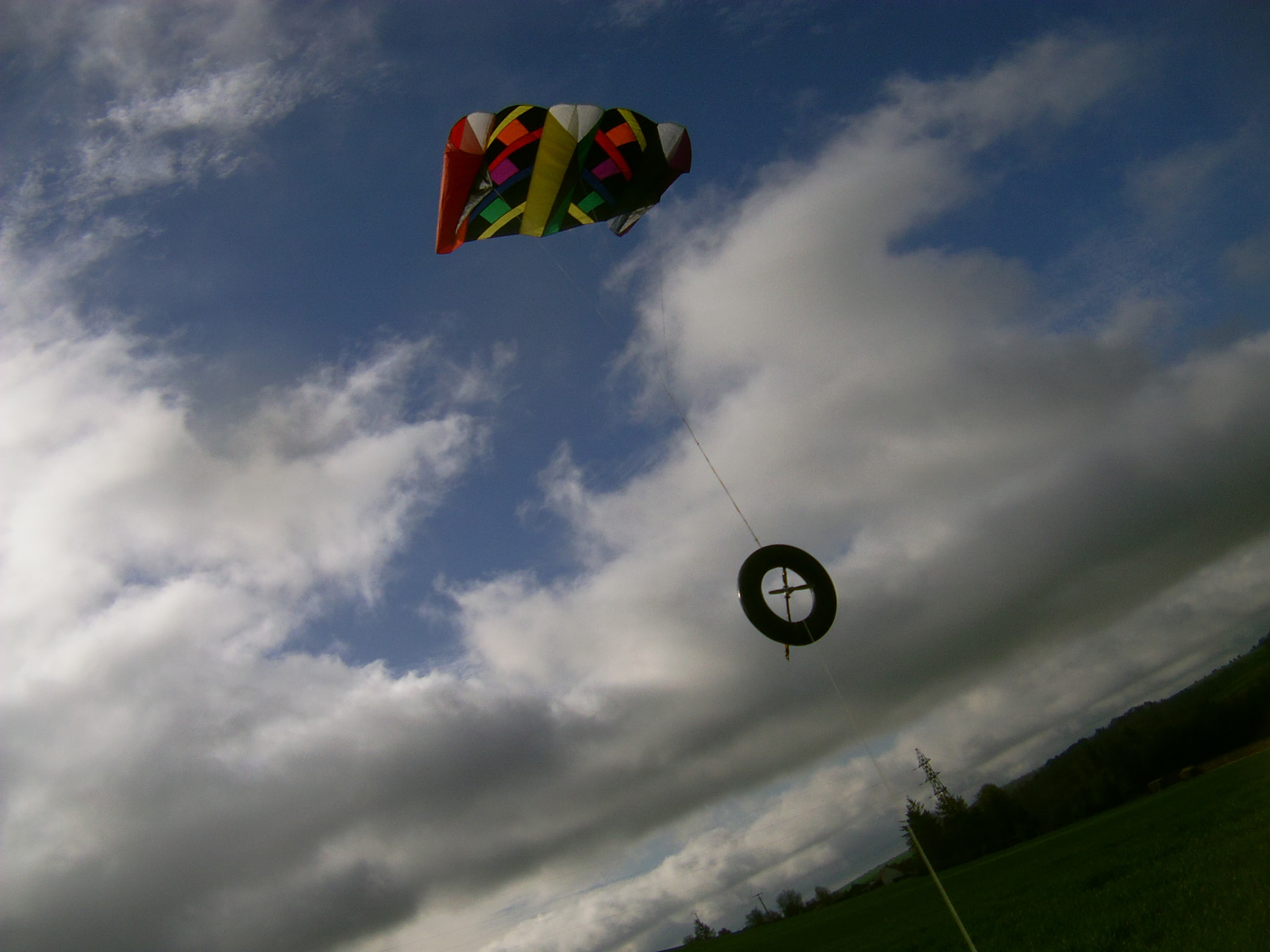

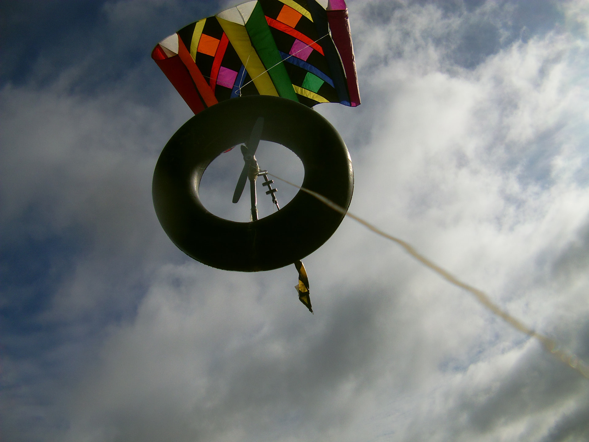

Some photos:
The wind vane improves stability.
