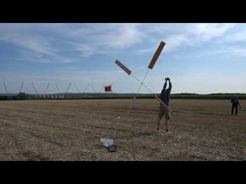

You can see @someAWE_cb performing this exact function in his latest test
Using a small loop radius and the fact he’s so tall just about satisfies this need.
Maybe if he used his wobbly anemometer mast to catch the top of the turbine it would be more effective… That’s kinda what I’m planning to try soon. TV crew here tomorrow to film our kite flying. Wish us luck. The old kite hasn’t been in the air in over a year now. It’s not changed much.
… and doing a horrible job at it :wink:
/cb
