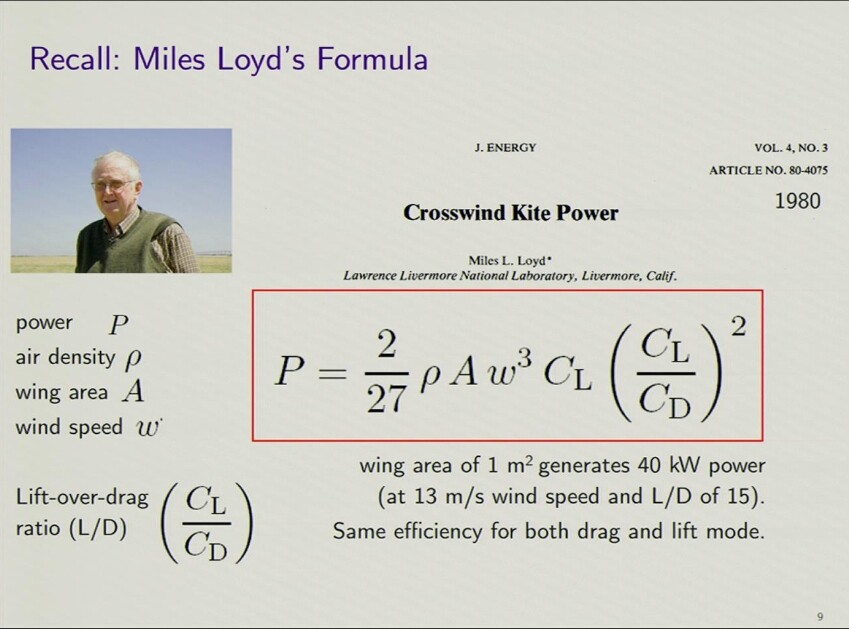

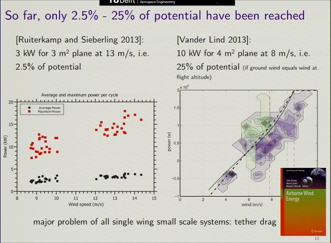

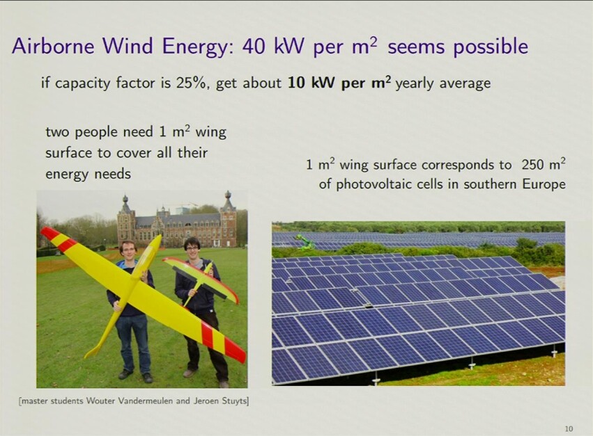

A screenshot at 3:07:
Makani Ampyx Capture d’écran17-9-202611813collegerama.tudelft.nl
How to interpret this expression: “i.e. 25% of potential (if ground wind equals wind at flight altitude)”? By asking the question differently, what would happen to the 25% potential if the wind speed at ground level is, say, 4 m/s, instead of 8 m/s which would be the wind speed at flight altitude, which is not expressly stated?
Other screenshots, at 1:50 and at 2:30, indicate a full potential, leading to 40 kW per m².
40 kW Capture d’écran17-9-2026161817collegerama.tudelft.nl
40 kW per m² Capture d’écran17-9-2026161936collegerama.tudelft.nl
Maybe it is related to calculating the drag of the tether along its entire length.
This is a major point.
