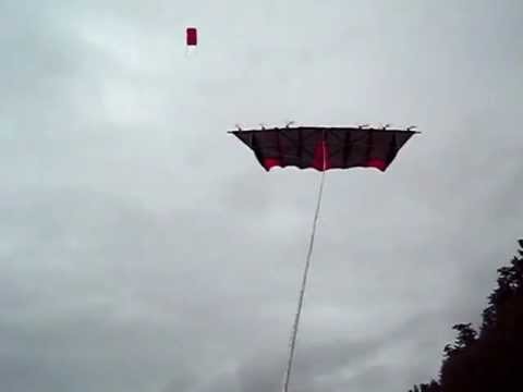

But if the same wind turbine is lifted by at least one static kite, the whole becomes a “noncrosswind AWES” like on (with several turbines in fact):
