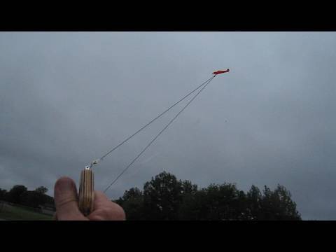

This is draft comment from July 2022 I didn’t submit:
I liked this answer down the page (partial quote):
A linked video from above answer of an rc plane flying circles connected to a tether: Art’s RTP plane - YouTube
From 4:55: control by two tethers fixed to the cord of the inner wing and acting the elevator of the stabilizer (if I saw correctly). See also the controlled flight at about 6:10, then the full video. Perhaps some ideas for The Pyramid or some kinds of CSR?
Control line flying works with only one input because the wings are constrained to be in line with the lines. In the Pyramid, there is a single tether attachment point, so there the wings aren’t constrained like that.
I also don’t think ground control via tethers would work on a rotary torque transfer system if you have multiple kites on a line, and there is “triangular” bridling between kites at the same height, like the Daisy and Pyramid. If we assume the lines make a helix while torque transfer is happening, some of the kites would be on the bottom while others would be on top of the shaft, so they need different control inputs, while you only can send the same input up the line, “elevator down” for example.
And then there is the input lag of using control line input to kites on long lines, and mushy control through lines less than perfectly taut.
But you can of course fly (a train of) crosswind kites using ground control.
I guess it could be made to work. The Pyramid would require two control axes for roll and pitch. That means three tethers. And tension would probably have to be equal on all three tethers to avoid different performance in different windspeeds (slack tethers get much shorter than taught ones).
Im not sure how that would pan out though.
Pitch control is very sensitive. It makes sense to me to measure pitch onboard and then control it locally. Tether control seems harder for me, if you want to proceed further than a flying prototype. The challenge is open though for anyone who would like to try. I am not saying its a dead end
