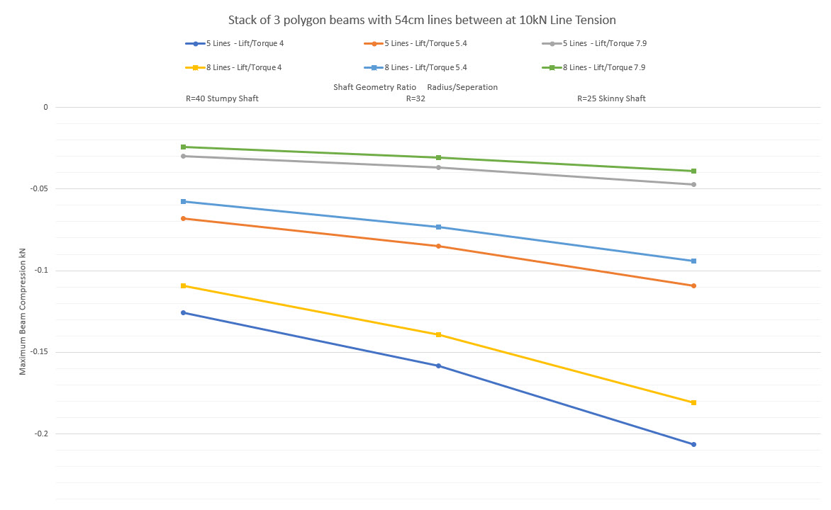

Using only 3 rings in a stack the maximum compression seems slightly less…
Probably due to the distance between the fixed ring and the top driven ring.
Nah… it’s around exactly the same… and proves my stubbornness wasted a lot of time previously
Certainly speeds up the simulation though.

Ran another set of simulations at this time at 10kN
Steady pattern again (horizontal data flipped this time)
