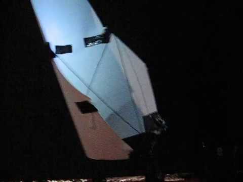

It more or less reminds me of the experiments I tried using some kind of parachute. But I did not go as far as you, and by far: there is no generator…, but each anchor is a dog leash comprising a spring, working in such a way that the spring is tensioned during gusts and released during lulls.
those were the first attempts. it may be that something is possible. i got the best results with these 2 kites. a pump mechanism with elastic bands seems to improve the efficiency. here is an attempt:
