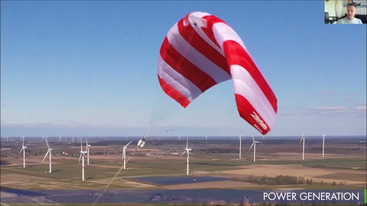

The Hamburg-based company SkySails Power GmbH is ready to deliver the first PN-14 airborne wind energy systems. The first unit of this pre-series will be shipped to Asia from the port of Hamburg this week. Further units for projects in Germany and on the island of Mauritius are on track for the first half of 2021.
The final assembly of the airborne wind energy systems takes place in Seevetal, Lower Saxony. The ground stations, weighing in at roughly 20 tons, are manufactured in a 900-square-meter production hangar along with the power generation unit and the kiteâs launch and landing mast. It has already become apparent that the production facilityâs current capacity will have to be significantly expanded in the coming years. SkySails Power GmbH currently employs around 90 people at locations in the Hamburg metropolitan area, Schleswig-Holstein and Lower Saxony. âWe will be creating numerous additional jobs in northern Germany in the coming years. Here at the Seevetal site, the focus will be on employing skilled workers in electrics and mechanicsâ, says SkySails CEO Stephan Wrage.
Hi @rschmehl , indeed there are some informations on:
BASELOAD ONSHORE WIND POWER THATâS AVAILABLE ANYTIME AND ANYWHERE
The SKS PN-14 harnesses the wind at an altitude of 200 to 400 meters and also achieves high yields at low-wind sites. The system is safely employable in hurricane and typhoon regions, as it is easily retrieved and stowed away before these natural disasters occur. Thanks to its simple transportation and installation requirements, the SKS PN-14 can also be installed in places that are difficult to access.
The SKS PN-14 achieves a high amount of full load hours (up to 6,000 full load hours/year). It is the first time a renewable energy alternative can compete with conventional solutions such as brown coal for supplying baseload power.

Not sure I could sit thru another hour of kite-reeling talk, but I will note: I skipped ahead a few minutes and once again saw that graphic comparing winds at 10 meters AGL height to winds at 200 meters AGL height.
Meanwhile, the guy in the video just said wind turbine blades reach 200 m height anyway. So modern wind turbines already reach up into the same basic altitude range they are targeting anyway.
Yes, Iâve noticed, flying kites here in the wide-open Mojave Desert (in the wide-open backyard), a kite is still not quite even stable at a 10 meter height, and the pull on the string is not steady or strong. Just a few meters higher and the pull gets way stronger and steadier.
Meanwhile, modern wind turbines operate quite a bit higher than 10 meters.
So showing those worldwide wind color charts comparing 10 m winds to 200 m winds would seem to be a bit dishonest, designed to sway the viewer more than facts merit, in favor of the kites.
In other words, if wind turbines do not operate at 10 meters height, why do they compare their target wind resource to a 10 meter height?
Answer: Because it makes their advantage look more impressive than it really is. And remember, they just said regular turbine blades do reach up to 200 meters at the tips.
So that is where we can see a cherry-picking of what info to present, and in the case of the wind resource, the data shown is misleading.
