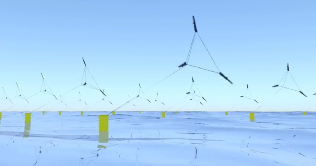

This company developed a rotary flygen system: see the website then the video below:
https://www.f6s.com/bladetipsenergy
Conceived also a yo-yo rotary system:
I think this is a very good design, as it allows very high altitude operation while still having a sensible takeoff and landing plan.
Personally I prefer The Pyramid, as the rotary power transfer makes even less of the machinery airborne and what is airborne is this much simpler.
The two designs have a few similarities IMHO. Bladetips though is the only of these two that can attain very high altitude
Facebook page was updated 2016 though, web page is gone.
This is the last copy of their web page from wayback machine
https://web.archive.org/web/20191228164348/http://bladetipsenergy.com/
I would also like to mention that using the turbine blade with an assistant forward thrust motor to generate lift like this will probably reduce the VTOL added weight. This way also they are avoiding the issue with turbine + propeller combined blades, which for eg. Makani designs would have the lift of the turbine blades facing in opposite direction depending onb VTOL or power production mode. For this design, the blades always lift away from the ground attachment point.

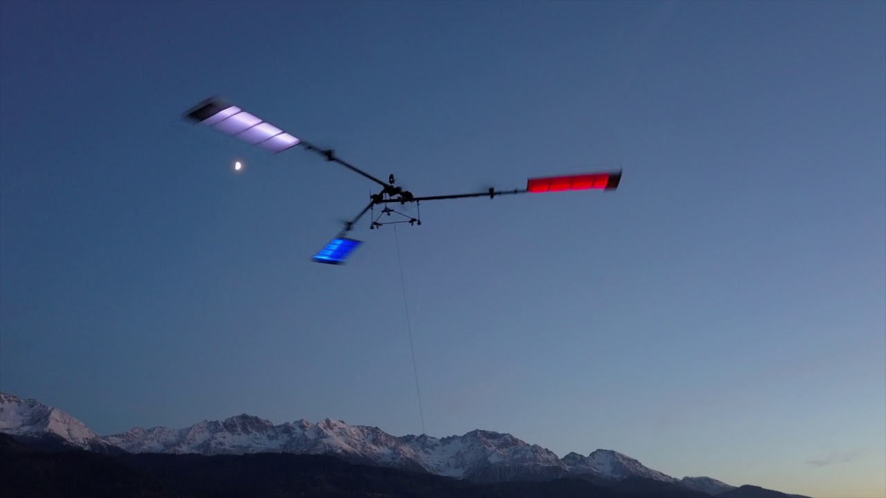

The principle highlighted by AlphAnemo is very similar.
While our competitors still stick to a single kite, we go the next step. Our patent-pending centrifugally-stiffened three-wing design unlocks an entirely new mode of operation for Airborne Wind Energy.
You could say the same thing about Bladetips, whose design seems outdated. Or maybe the project contributors were common at some point or another.
