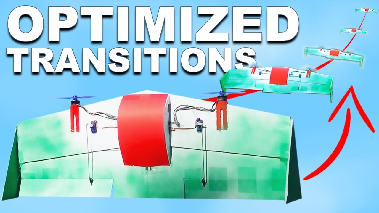

Transition from hover to forward
I’m a big fan of Nicholas Rhem and his software
Many AWES utilise a flight regime transition
Are any of them as well designed or explained as this ?

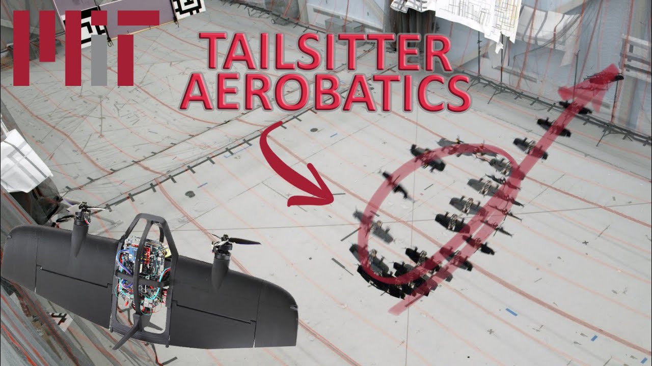

People at MIT are working on this:
https://aera.mit.edu/projects/aerobatic-maneuvers-for-fixed-wing-vtol-aircraft
A video by them:
Aerobatic flights and all the transitions seem so simple when there is no energy generation as such and no tether.
So true
Bridles and tethering add a lot of complexity to the system control
Yes. And multiplied many times over if fail safe is to be considered.
I was looking at this and good news is that its quite easy to control a tailsitter. I don’t really get to engaged in the roll becomes yaw discussion. Maybe just need to rethink stick mapping. I mean, people do already hover with «3D model planes». Maybe just a matter of pilot skill rather than fruitful R&D material. Anyways, for AWE the problem is moot because a computer pilot will not care

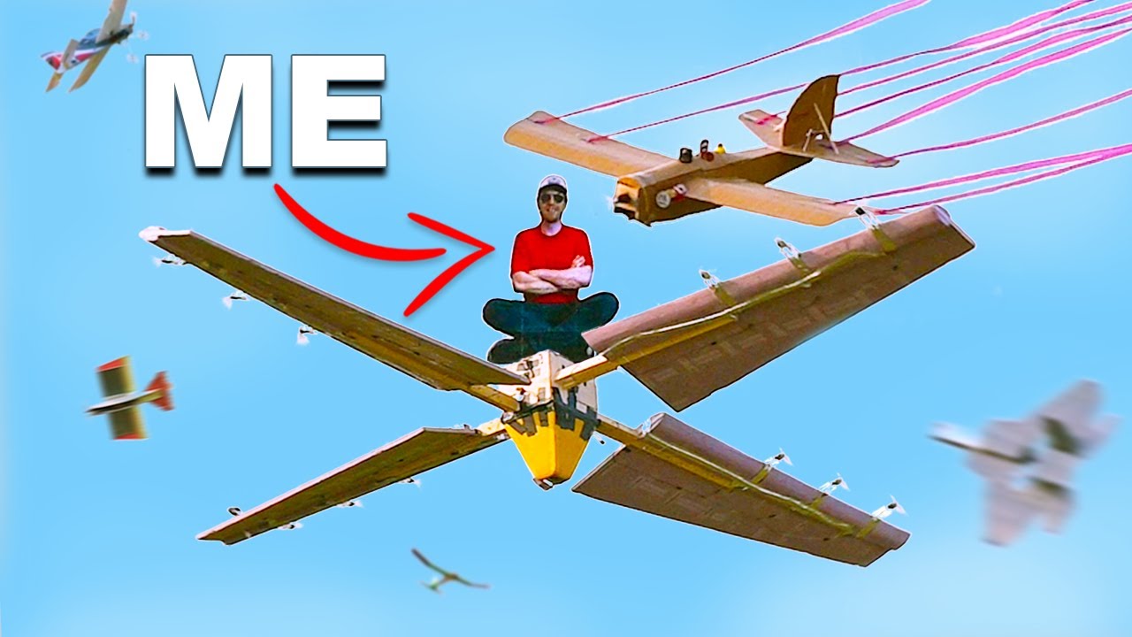

A giant RC rotor with 12 tip and leading edge props at
Flite Fest
Our man Nicholas Rhem again
Some reasons to put those last 2 videos in the chat
Tip prop powered rotors are efficient to launch
They have good control
They can lift a tether
They can be powered by a tether
They can kite (Bridle the wings and use as an autogyro)
Anyone reckon they can be useful as an AWES lifter?
To sum up, they can be an AWES.
