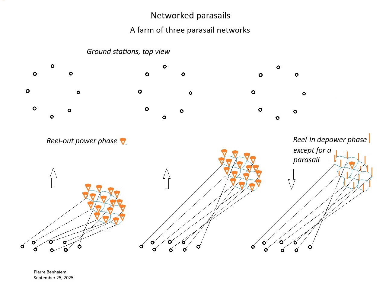

Networked parasails working in yo-yo mode could look like Daisy’s network, the parasails replacing the lifter kites, and also being used without the rotary devices.
The argument in favor of networks could apply in this specific case, to avoid this (for unnetworked AWES):
Trains of parasails could perhaps increase the total swept area.
It is not impossible at first glance to imagine that some parasails or parasail trains are in the power reel-out phase while others are in the depower reel-in phase within the same network, leading to continuous power.

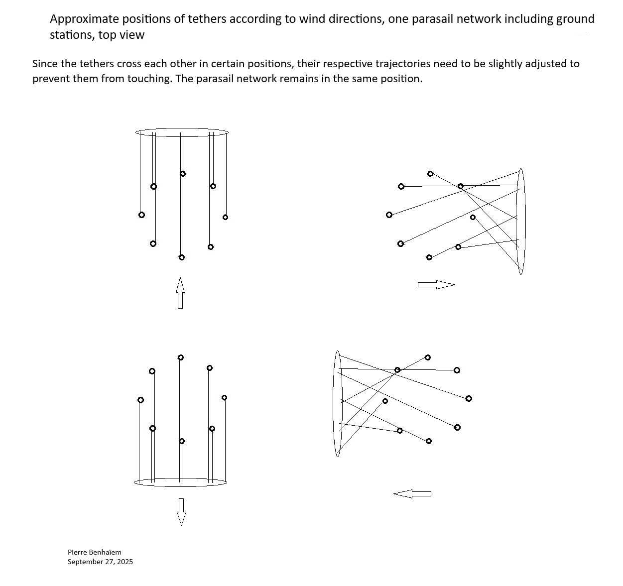

That said, to supply continuous power, several (2 or 3 at a minimum and not much more at a maximum) networks of parasails with offsets may be better suited to provide the reel-out and reel-in phases in the same time. But in that case, a least one parasail for each network, always in action, would be necessary to ensure a minimum of lift during the depower reel-in phases.
There would be several ground stations, but less than for unnetworked parasails.

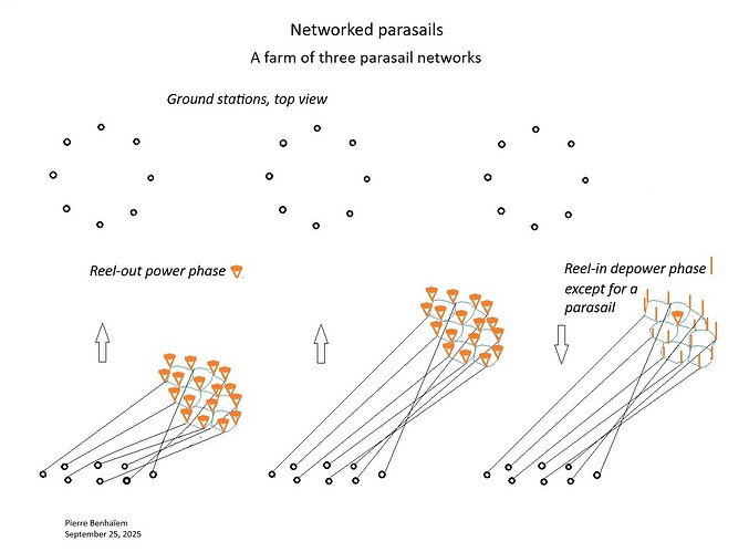

A sketch:
Networked parasails
An alternative is to bring the units together in networks, to avoid duplicating certain elements such as the main tethers, and to save space. This technique is developed by Dave Santos [27] and Roderick Read [28]. To supply continuous power, several (2 or 3 at a minimum and not much more at a maximum) networks of parasails with offsets may be suited to provide the reel-out and reel-in phases at the same time, leading to a continuous global power. But in that case, a least one parasail for each network, will be always in action to ensure a minimum of lift during the depower reel-in phases. Ground stations can pivot to face the wind direction in a similar way as for other arrangements. Note that during changes in wind direction, the same configuration is achieved by lengthening or shortening the respective pivoting ground station tethers. If necessary, the parasails can be equipped with respective swivels, possibly motorized, to facilitate their positioning face to the wind.
Trains of parasails can be seen as networked parasails but are not used in this configuration: simple parasail units are preferred, being arranged to cover the swept wind space.

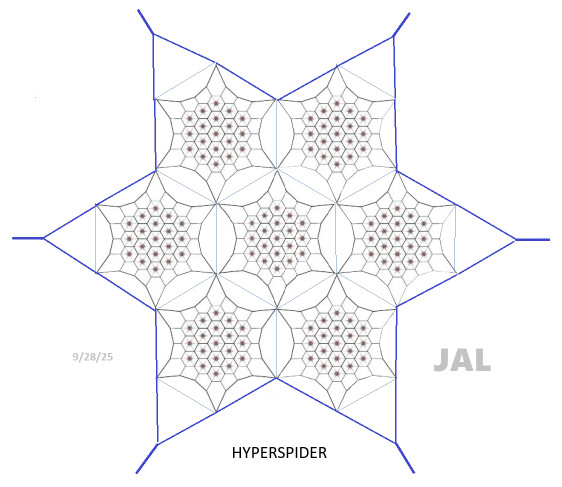

From Dave, writing “AI agrees that a further hyper-scaling stage is possible, fitting neatly under the 10km upper wind boundary.”
I would name it “a network of networks”, or “networked networks”. Concerning Dave’s comment, I would be more cautious about what AI can actually claim. In addition, I know only one way to prove the proper functioning of a kite network: testing it with a generator, in different configurations (lifter kites or tether-aligned (yo-yo mode) or crosswind kites or others).
