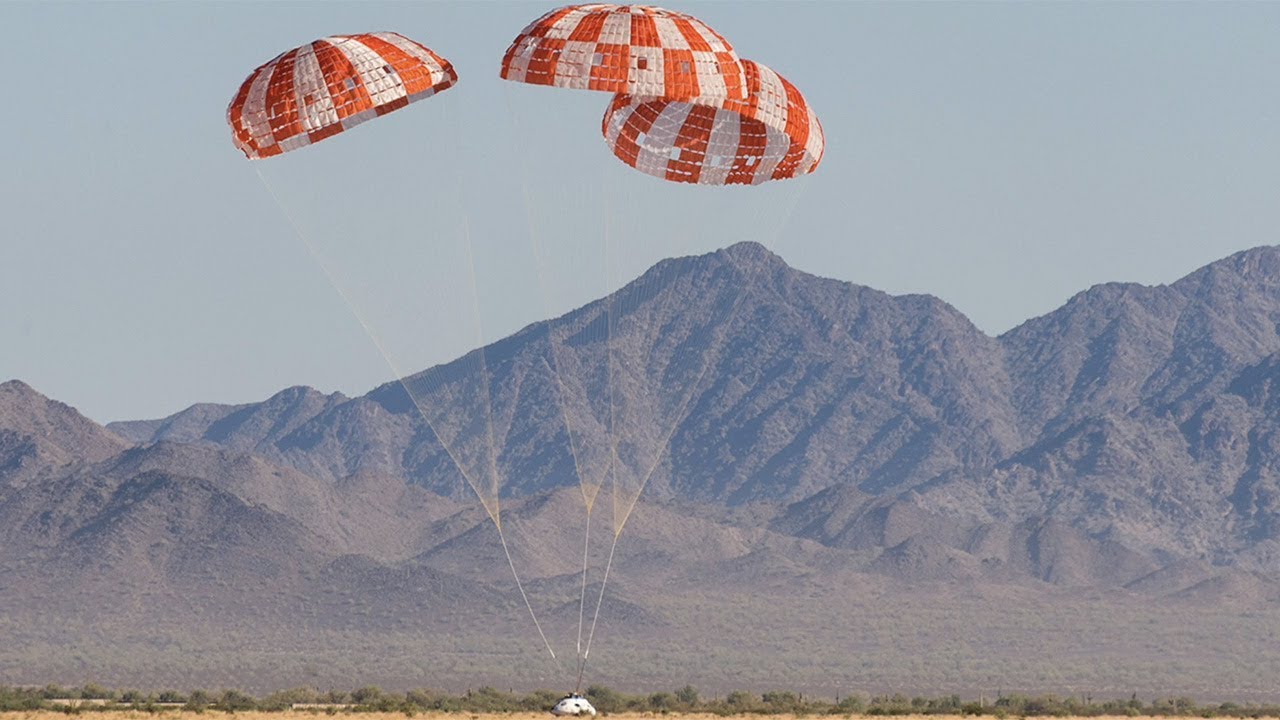

Listen to the commentary in the Orion capsule recovery video… Tens of thousands of pounds of force on those parachutes when they inflate. There’s a very fast transition in the Zhonglu video from deflated to inflated. That would create a shock load on the capsu
