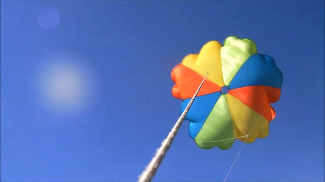

Parachute game as kite
A parachute game is something like https://www.amazon.com/Parachute-Game/s?k=Parachute+Game.
It is not expensive.
I wanted to transform it into a parachute kite. I put two groups of eight double (= 16) suspension lines then two lines allowing the control of the altitude. But this parachute kite is not stable enough.
Flat diameter: 320 cm; diameter when it is inflated: about 260 cm; area: about 5-6 m² when inflated. Measured thrust, wind about 6-7 m/s: 160 N. When the wind speed was higher, I had to drop one of the two lines to depower it (a depower system for study?).
If I can control the stability, both longitudinal and transverse, it might make a good parachute kite for a kite-reeling (yo-yo) system. After perhaps it would be suitable for a not advanced kite network. Perhaps some other static kites could allow the same.

A final calculation is not even possible: nobody knows how long the kites (especially flexible ones) will last during a continuous operation. 1 year seems to me to be an optimist estimate, even for a parachute kite.
After some investigations, I saw that the Power Harvesting Factor ζ of a parachute kite would be 1/10 or 1/15 that of a flexible crosswind kite of type Skysails or @Kitepower. The expected advantages such like opportunities to bring units together would be cancelled by the requirement of stability, leading to additional devices (holes, nozzles) which increase the cost (an ascending parachute is not so cheap) and remove isotropic features.
