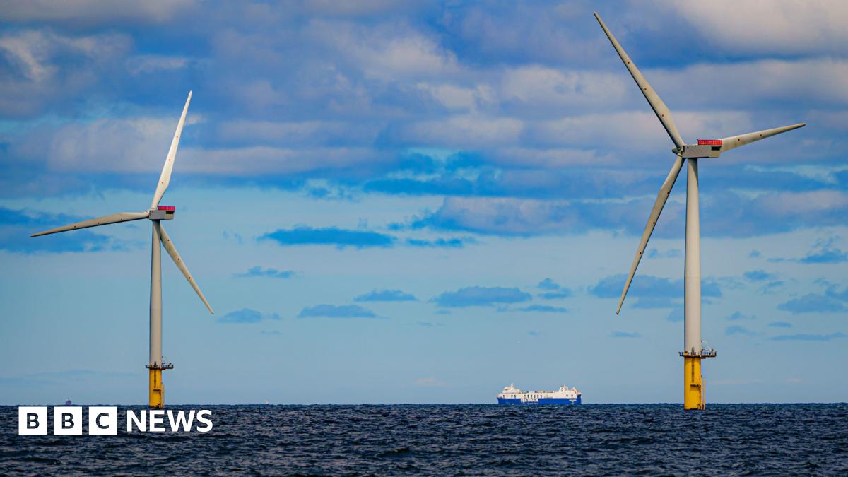

Thanks Doug, The stories all tie together
A Chinese multi rotor company wanting to invest in Scotland
The home of Multi Rotor wind energy scaling and Peter Jamieson
