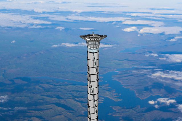

The tower would be built out of stacked kevlar cells inflated to extreme pressures with hydrogen or helium gas. Flywheels would be used to stabilize the structure, as the structure is much too tall for guywires to work. The tower is designed to be able to survive Category 5 hurricanes.
Among other projected uses for the tower would be as a communications tower, low-altitude replacement for satellites, high-altitude wind turbine platforms.

Home | Thothx
In project: “high-altitude wind turbine platforms”. This inflatable tower could also be a basis for AWES, like Crosswind Kite Power with Tower, and others.
From ground-level winds to jet streams.
Brendan Quine - Thothx Space Elevator (time-stamp 1) | time-stamp 2
They built a 3 story test version. They describe wrinkling as a problem. I like that it is a tube, not a giant cylinder, and is made out of smaller cells, which makes the hoop stress much less of a problem, and makes it easier to manufacture.
Assuming AWE does not need to send elevators up and down, you could make a smaller, lattice tower version. I would combine the concept with Tensairity, and a tensairity torus idea which I think basically solves the wrinkling problem and makes the beams/cells 10-100 times more resistant to buckling.
