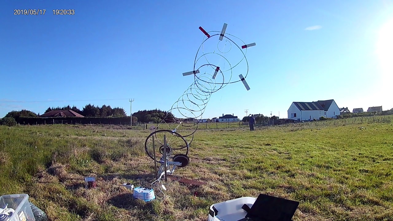

Can the kitegen carousel be considered a large scale torque system design,… driving kites continuously around a large ground ring
and
Kite turbines are able to maintain and expand their stacked ring form without using any rigid material.
I have pointed this out here on
and in physical tests where you see the kite rings expanding… e.g. look again at these rigid blades whinging around with almost soft structure between them… Both kite rings are adding torque to the set and expanding the whole cone shape as modelled… (although offset a 1/6 turn in this config)
also, compression on TRPT components is REDUCED, for similar transmission conditions when the line count is increased. This is a section which does not have to scale length. I’d happily accept any EVIDENCE to the contrary.
Also…Blade length does not have to scale with number on ring or diameter of ring.

The TRPT shaft length of a kite turbine doesn’t scale with kite turbine size. The ratio of gap between rings to ring diameter is constant. The wing length can stay constant for any size of kite turbine. You can scale by number of kites on a ring. This means at a certain diameter the TRPT can just disappear… e.g. not be there… The blades are way above the ground in a single hoop to hoop hop.
How can a thing, which isn’t there, have any weight? You’re going to have real trouble trying to explain that to me @PierreB

But the rigid parts yes.
The shaft with rigid rings is on all the photos and the videos. But perhaps they are made in an empty material. The rotors with their respective kites are another affair.
A main point: the rigid rings undergo not only the torque but other forces that are provoked by wind changes.
