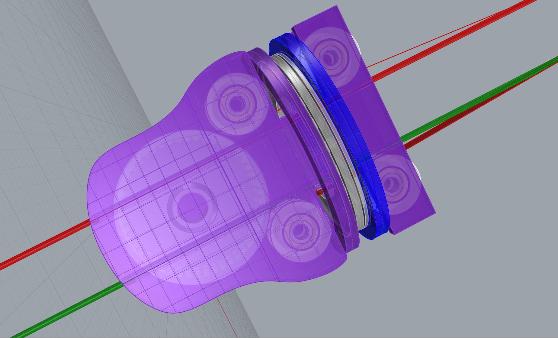

When using an active kite to support a daisy kite turbine , we will have to consider what happens at the top bearing.
The top bearing is used to lift the kite turbine in launch and land.
The lines which steer the active lifting kite, will have to pass through this bearing.
but also support the thrust added to this bearing which holds up the kite turbine during launch and land.
I suspect the best way to do that is to have a mixer pulley at the centre under this bearing which holds the two forward lines from the upper side, e.g. linked to the active lift kite.
The two forward steer lines from the lower side (linked to the OKE) would also have to pass through the bearing to connect to the upper side lines so that they could actuate the kite against the mixer band
Here’s a rough outline sketch …
The red and green kite lines pass through the thrust bearing (grey) and purple block structure.
The 2 lines attach above the block and bearing onto a belt (red)
The purple block structure holds the thrust bearing to the mixer pulley and guide pulleys.
The belt holds the pulleys and block up while allowing the different lengths of the red and green lines
The blue side of the thrust bearing is used to hold up kite turbine structures.
Thats a little out of my breadth, I think I may have to see a physical version, Do you happen to have a couple printers to test parts out?
