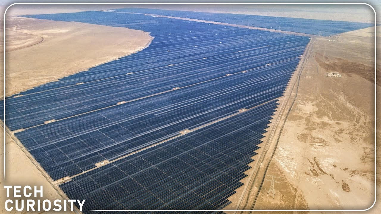

A solar power plant project:
A solar power plant achievement:
World’s Largest Solar Power Plant Site - Al Dhafra Solar
