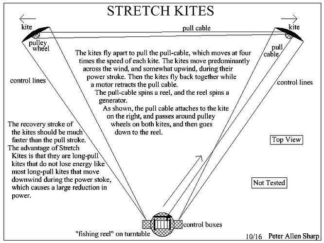

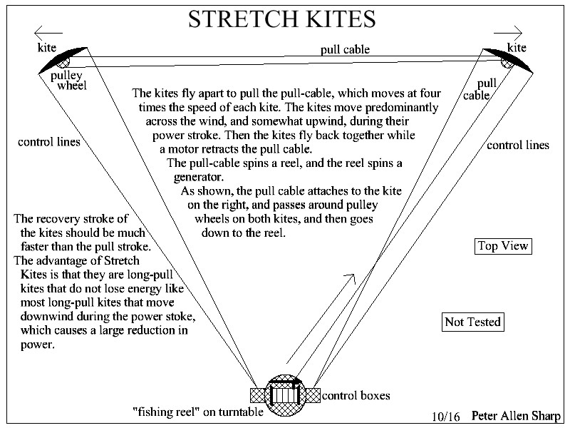

Apart from that, as a curiosity, we can see something apparently similar, but only in appearance. We do find the extendable side tether, but in this case it is used for power take-off (PTO).
Stretch kites,
Thank you very much for your feedback! Indeed this is a provisional application to obtain a priority date and be able to share the details with you and others. It does not meet the clarity standards of the EPO yet, but I will ask an experienced lawyer to take care of that. I am working on a more ā€œdigestableā€ document but these things take time to write. Elevons are both elevators and ailerons, i.e., an elevator with independent movement on each side. Having the ability to slightly shift the tension from one side of the wing to the other may still be useful, even if the roll angle stays constant. But I agree this is not necessarily needed so you can just think of them as elevators.
I’ve seen the stretch kites invention before, It is very different because the tether connecting the two kites moves during the generating phase. Our tether is orthogonal to the movement. I am not sure if anyone tested stretch kites in practice since the invention to see if one can gain efficiency using such a pull. At medium to large scale, I can’t imagine the pulleys have a D/d ratio large enough not to destroy the tether after a few days of operation, otherwise the drag would eat all the efficiency away. That is the main concern we try to avoid with fixed bridles. Even Dyneema rope fatigues extremely quickly, but if the reel is on the ground it can be bigger.
