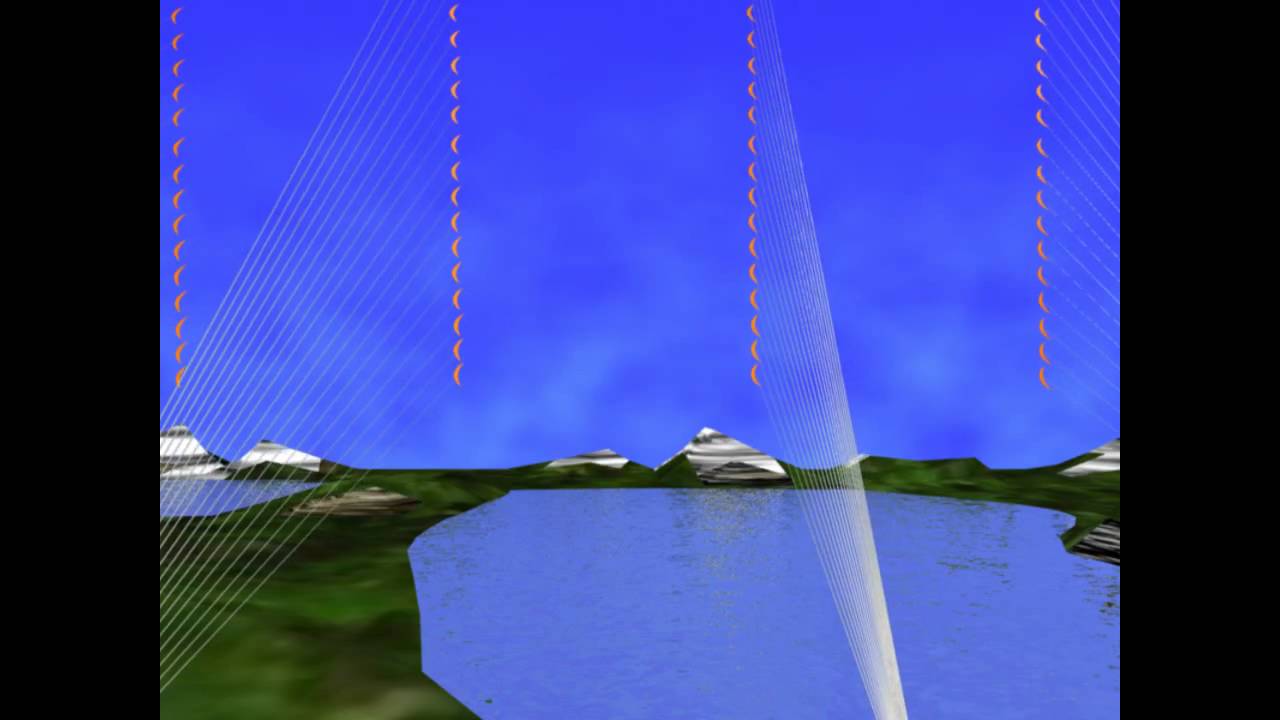

Perhaps this could relaunch R&D about crosswind stacked kites. That reminds me an old rendering:
Electric control would be suitable if (rigid or even soft) wings can do without it most of the time.
Are they wings or vertical stabilizers (drifts)?
If you are asking about the “Q-Fin” (which it is called, the yellow wing unit), they are placed inline with the streamer. As the streamer has little torsional stiffness it may rotate by a differential wing angle of the two wings, and then by using a common wing angle on both wings, a force may be applied in any direction.
As they are neutrally buyant they don’t really fly like an airplane. Though somewhat similar to a kite, they are also very different. The reason I mentioned them was just to argument that keeping many kites in the air at any one time perhaps is not entirely infeasible. It was difficult in seismic, and would be even more difficult with kites. But not impossible.

As an example of filling space the video on
shows large static kites with low spacing.
